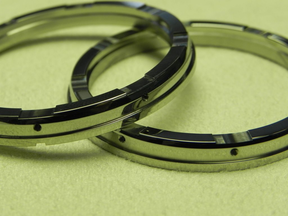

In order to perfect the look, the inner bezel ring has been machined accordingly.

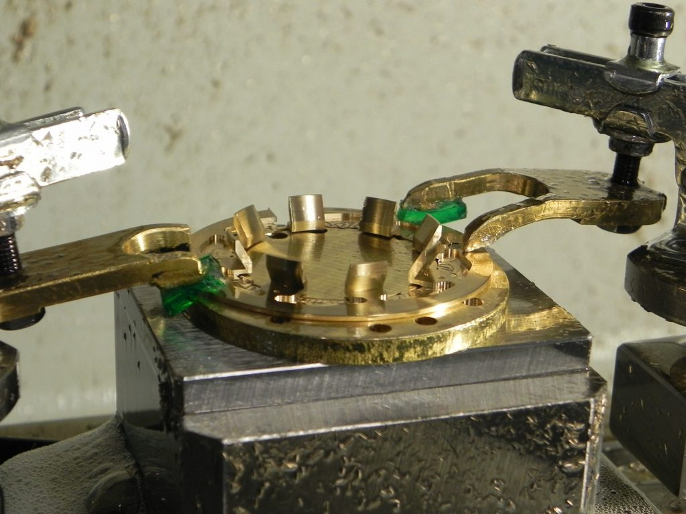

The other stumbling block of the machining process is the titanium case; as you most certainly know, this metal is particularly difficult to work with: because of its hardness, the high friction can set it to fire.
Therefore, very few brands transform it themselves. Here, the machining of the Blackspider's case takes more than seven hours, with CNC machines specially design to prevent fire hazards.
The bezel is the trickiest part to cut out, as it takes a five axes numerical control machine.

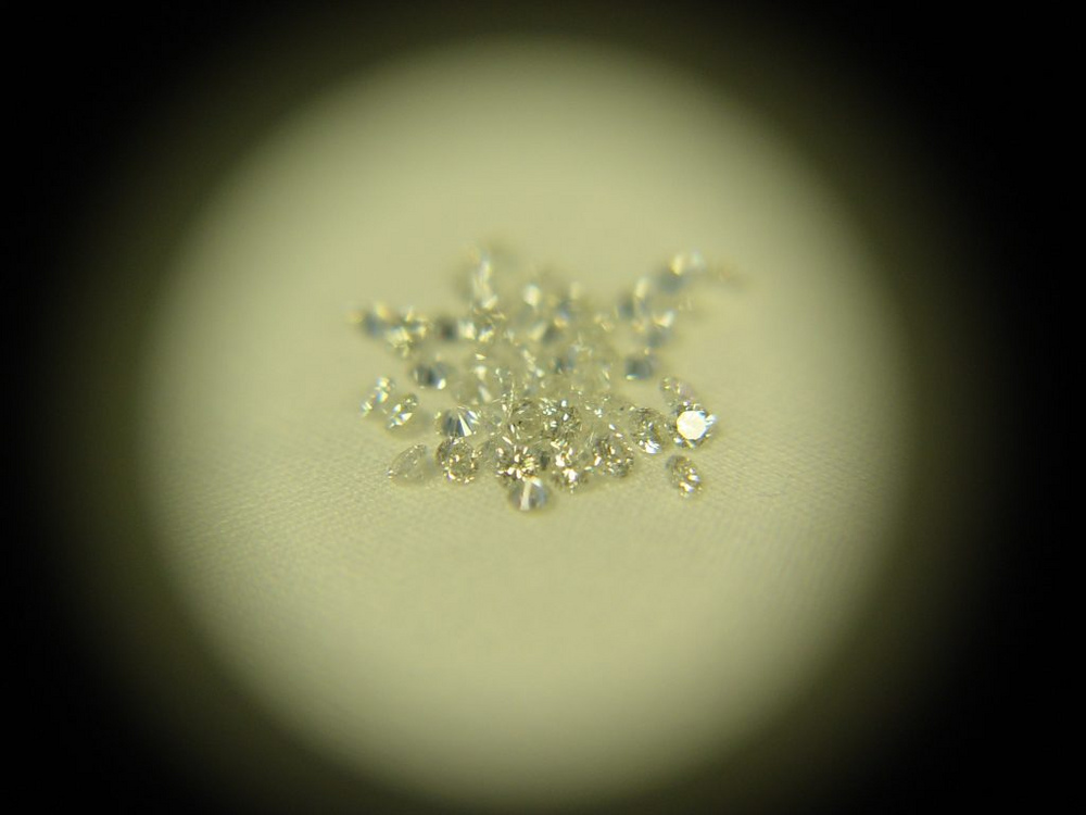

The gemsetting is of course the highlight of this unique piece. As the watch features an almost rough natural element, finding the gems of the right size is a fastidious task.
The next step is the diamonds cleavage; it is like splitting a log. There is a right orientation, with produces two cleanly cut stones. And there is a wrong one, where the diamond will break. If the splitting is properly done, it allows for the elimination of the flaws, which are generally located at the center of the gem.
Then, the diamond undergoes the bruting process, whereby the stone is ground with a diamond mill (of a higher hardness), down to its final shape.
Finally, the most difficult operation, the polishing, where the diamond gets all its facets and its brilliance. This step is performed manually, but of course, the diamond cutter uses a "Dop" (pliers) and a disc turning between 3000 and 4000 revs/min; But surprisingly, he also uses a computer, to guide his movements accurately.

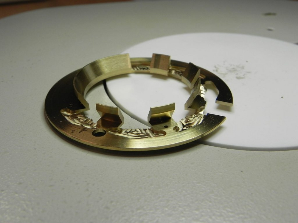

The gems are set using the "grain setting", which is one of the most resistant techniques.
The operation is particularly difficult on the flange, because of the thinness of the material (about 1mm):

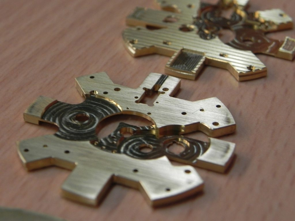

Once all the parts are cut out and set, the bridges can be finished. Then, the electroplating is performed. Finally, all the blackened parts are ready to be fitted together.
