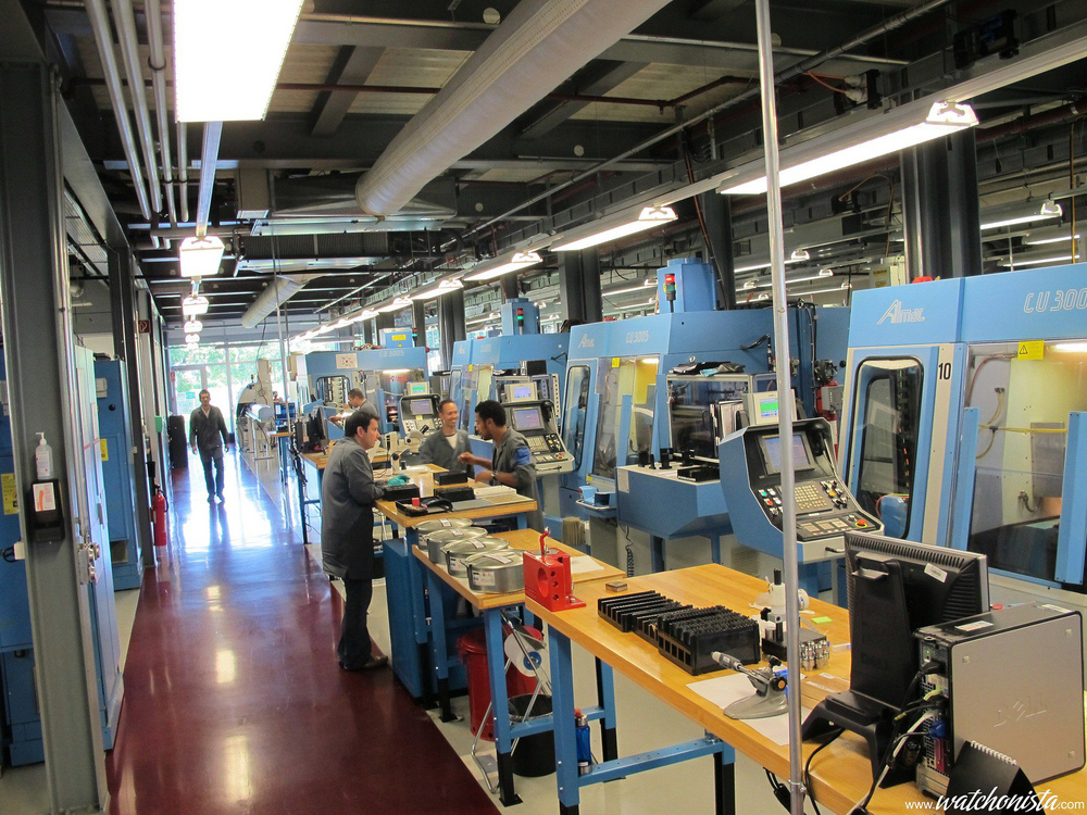

But when you enter the first floor of the Meyrin building, the most impressive is that you come face to face with automatic lathes. It is true that at first sight, a lathe is not really sexy (or at least far less than some finishers).
But even the most prestigious manufactories usually subcontract their screws to houses such as Affolter... The lathing process is generally associated with the making of wheels. It is an excellent way to guarantee an optimal reactivity during the production of these types of components, for example to adapt the dimensions for the polishing process.

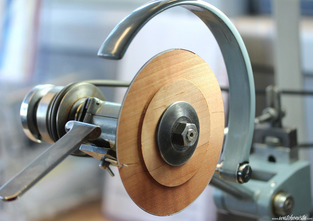

The wheels, the pinions and the screws will undergo systematic finishing processes (almost always polishing). In the diverse workshops, each finisher is specialized in one category of components.
For example, to finish the wheel teeth, one utilizes discs made of diverse woods, such as pear, beech wood, boxwood...The "mill" is slightly off centered with a piece of wood (usually a toothpick) , resulting in the elliptical movement of an endless screw, in order to alternatively pass between the teeth of every wheel;
The type of wood and the thickness of the "off-centering piece" depend on the kind of wheels to be polished. The polishing process in itself is pretty quick (between 3 and 15 seconds), but the protection and the storage of wheels takes most of the time invested in the procedure.
So, the pinions are produced in the adjoining workshop. For example, the polishing of a wheel's pinions takes 17 different operations, performed by the same operator.
Therefore, the technician must switch machines and tune them accordingly, as many times as necessary.
Considering the tiny scale of these components, it is an ant's work, literally.
The other main activity of Roger Dubuis Manufactory's first floor is the cutting of the bridges and plates.
The cutting processes are quite common and are generally performed on brass blocks.

In a similar way, the decorations of these components are machined, notably with a digital engine-turning machine;
Indeed, machines are more dependable in their motions and more economical in their material savings, a valuable quality regarding the stability of skeletonized parts.
